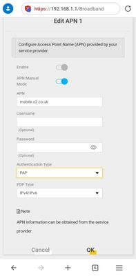

These are the DNS and cellular APN settings screens it gives.

  • 155089 Posts
  • 659 Topics
  • 29466 Solutions
@Cocat2517
No need for the DNS info. This should be set automatically or choose "auto"
Might be an issue with it being a Three device though.
