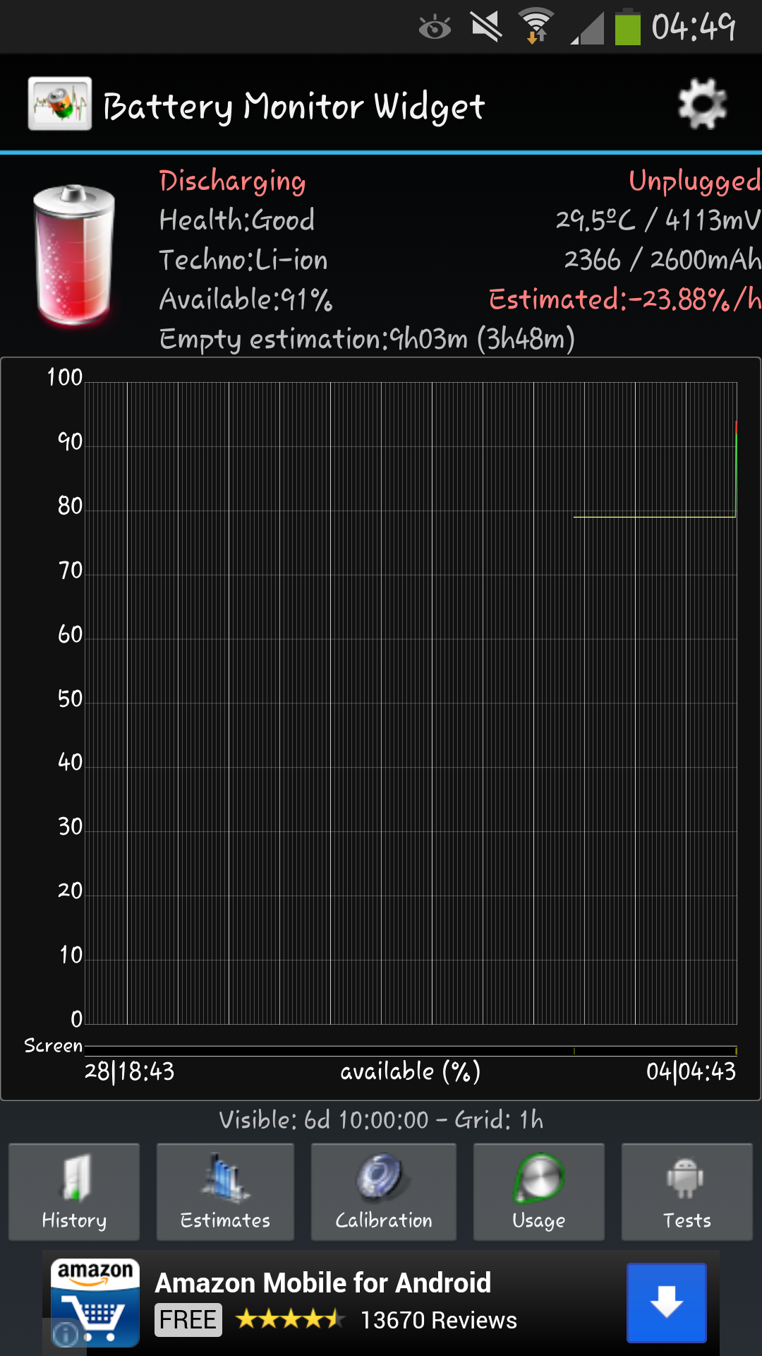

I too installed the battery monitor app, went to "Test" tab on the bottom right, and changed the option to LTE/GSM/CDMA.
Then my phone found the 4g network and worked well.
I know it's only a temporary fix, and I'm still waiting for the S4 update so that I don't have to have a widget I have no interest in installed on my phone just to get 4g.
But saying that, it enabled the 4g on my phone, when the LTE option most definitely wasn't available in the network settings on the phone.

Right
After installing the app, click on Test in the bottom right corner
Then click Device Information and scroll down, if you click the first drop down box you will get
Select LTE and away you go
Hope this helps.

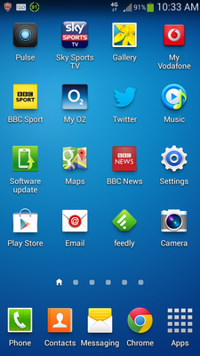

Guys the update for the mini and I'm guessing the s4 regular is out now. I am downloading it as we speak via the Samsung Kies Application on my mac. http://www.samsung.com/uk/support/usefulsoftware/KIES/JSP
Will update this post if it all works
UPDATE
Yes it works..attached screenshot and now in the mobile settings it connects and shows the LTE option that was missing. For me the firmware is now i9195XXUAMH2 (Samsung S4 MINI boughtsim free from Carphone Warehouse) My sources have heard that the Samsung Mega should be available at the end of the week. As for the regular S4 I am guessing it is the same as the mini and available now either OTA or via the Kies Software. I got a strange message when trying the OTA saying maximum attempts had been used so though I would try using the Kies instead. Hope this works for you.
