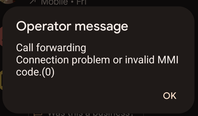

Tried **61*901*11*10#
received message
Call forwarding when no reply for all Speech Services
Connection problem or invalid MMI code
"Samsung Android" phone ?
Message 46 of 55

I got to test this MMI code when roaming, briefly, on 3Ireland - MMI code error:
Think I'll stick as I am and not use Voicemail, if anyone wants to talk to me that badly, they'll call again when I am in range or when I am not already in a call - problem solved! 😎
