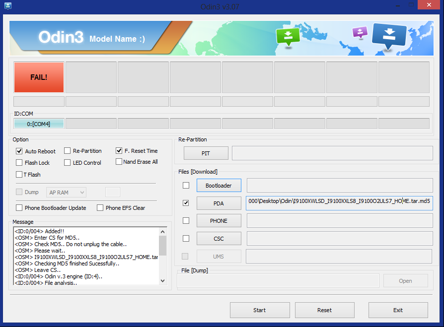

Okay I will do and this is what Odin shows: The blue box is confirmation of the phone being connected right? (it goes blue the second my phone is plugged in)
Message 13 of 32
4,661 Views
  • 153159 Posts
  • 653 Topics
  • 29232 Solutions
Yes, that all looks OK. If it doesn't work next time try Odin 3.04 instead from here http://www.android.gs/download-odin-3-04/

Can you post the full content of the message box for me....
Message 16 of 32
4,644 Views
Sure:
<ID:0/003> Added!!
<OSM> Enter CS for MD5..
<OSM> Check MD5.. Do not unplug the cable..
<OSM> Please wait..
<OSM> I9100XWLSD_I9100XXLS8_I9100O2ULS7_HOME.tar.md5 is valid.
<OSM> Checking MD5 finished Sucessfully..
<OSM> Leave CS..
<ID:0/003> Odin v.3 engine (ID:3)..
<ID:0/003> File analysis..
<ID:0/003> SetupConnection..
<ID:0/003> Initialzation..
<ID:0/003> Get PIT for mapping..
<ID:0/003> Firmware update start..
<ID:0/003> boot.bin
<ID:0/003> NAND Write Start!!
<ID:0/003> Complete(Write) operation failed.
<ID:0/003> Added!!
<OSM> All threads completed. (succeed 0 / failed 1)
Message 17 of 32
