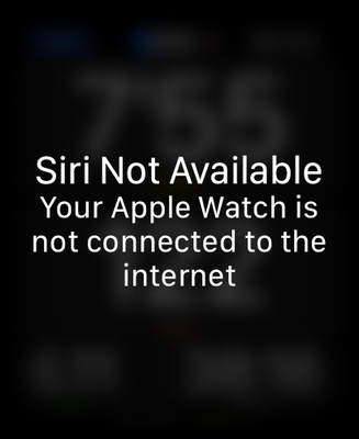

Still no joy 😞 From last nights run
incoming-3CF52E28-4AD1-4BAE-BB58-07E81CA5F5FF.PNGincoming-AF7C73CA-B56F-4476-A040-4523A4A02579.PNGincoming-BF230869-52AC-4190-970F-60A351B240B6.PNG
