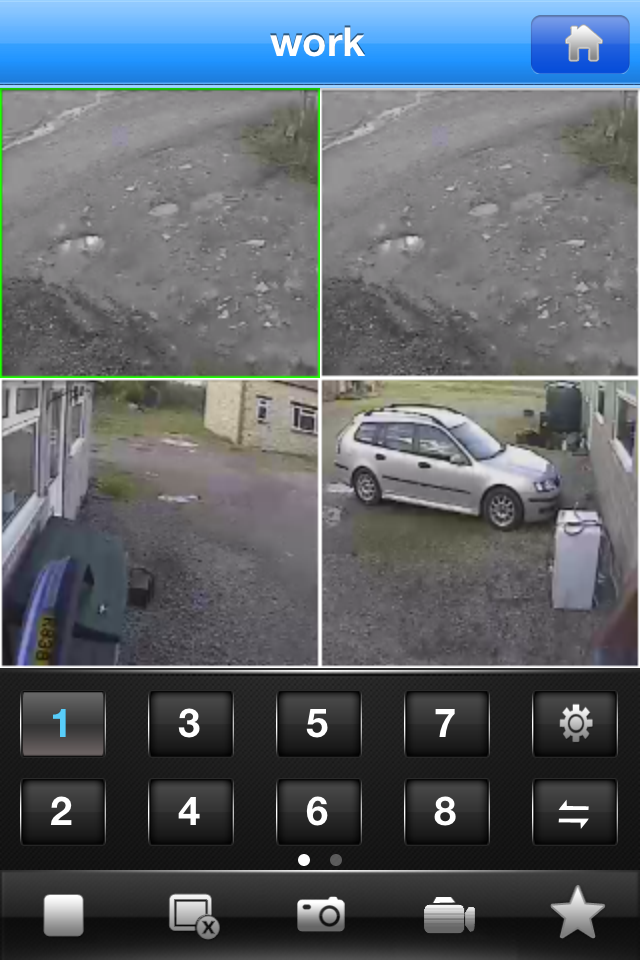

Here was the screen grab i did yesterday and speed test in mynetwork app
