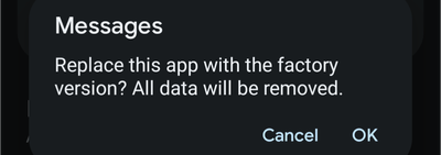

A little tip for users of Google Pixel phones who are having trouble sending SMS to O2 Short Codes (I was trying to send "INFO TESCO" to 61202, O2 Open, but kept coming up against a "not sending" error in the SMS app):
1. Turning off Dial Assist (or Assisted Dialling) in the phone dialer app - did not help in this case
2. Editing the contact for 61202 in Messages to remove the "+44" in front of the 61202 - nope, the +44 resolutely remained prefixed to the short code: "+4461202" after saving (!?!)
3. Going into Google Contacts in a browser and removing the default Country on my account - impossible to do, there has to be a Country showing in there, it seems, there is no option for "blank" or "Nowhere" in the list of available countries!
4. Force-stopping my SMS messages app and "Clear Cache" did not help.
Now what worked:
5. Long-press on my SMS Messaging app, Google Messages, and then up to the 3 dots at top-right, then "Uninstall updates" is what fixed it.
It said "All data will be removed":
but I did not lose anything as far as I can tell - apart from the phantom +44 in front of my "61202" stored contact.
6. On restarting the Messages app, it went through the initial authentication for my Gmail account and asked me if I wanted to use RCS (yes, I do!).
7. Going into the Google Play Store and updating the Messages app seems not to have removed the restored functionality.
8. I may reinstate "Assisted Dialling" later, not certain how that setting impacted the stored, or possibly migrated from an earlier phone, contact info I had for the contact "61202", yet... 🤔
Note: Apparently, some people have reported, after returning from holidays overseas, that they could no longer send SMS upon their return as the SMS app had reverted to prepending the IDD country code for the country they had been visiting, found this "fix" sorted their issue. Note: YMMV, E&OE 😁
