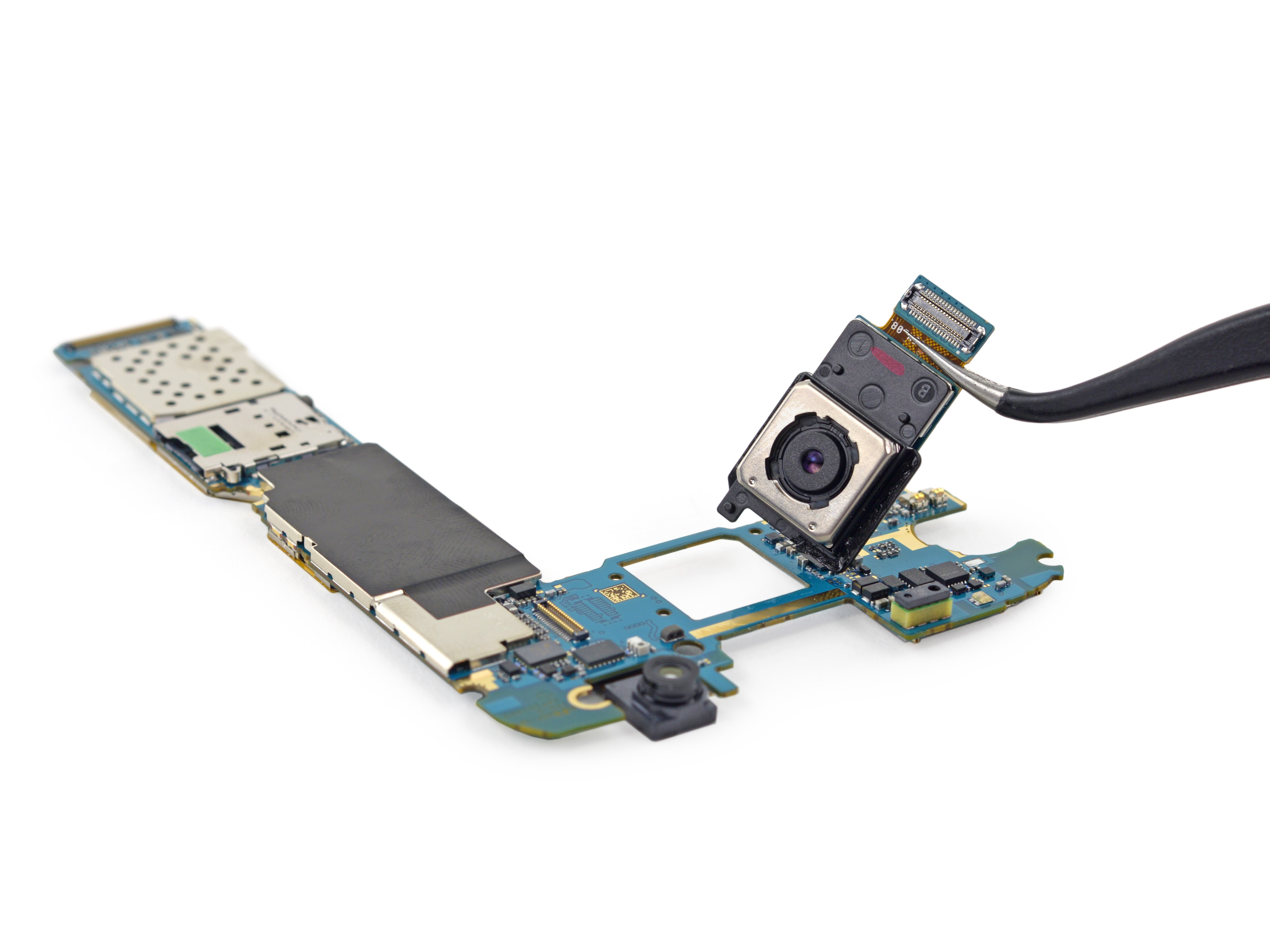

Right, just had to check the teardown, the camera module connects to the rear of the main board so to fix it they need to take off back, remove battery, remove main board and then replace the sensor. Then they would have to flash a new firmware that has the correct cam firmware.
50/50 on fix or replace, if replaced, I would expect a refurbished unit tbh

Crikey...thanks for that picture @viridis...who knew?
