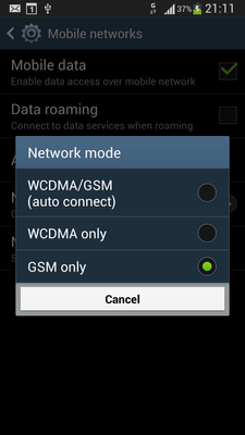

I tried setting up the network manually by going to Settings/More Networks/Mobile networks/Network Operators and both:
  • Manually setting it to the O2 network
  • Setting it to automatically select the preferred network
I found that when I manually set it to the O2 network the phone would briefly display a message saying that the phone was registered and that if I was quick I could, at this point, call the phone.  But very quickly the 'signal' was lost and the phone was off the network again.
I looked on the Internet and there are literally thousands of people who have had this message, many of whom had spent weeks trying to get the problem resolved but I couldn't see anyone who was showing a specific fix.
I used O2's chat facility to get technical support but the operator said it must be a locked phone (it isn't).  I asked how it could be locked if the phone could, on occasion, get a call.  We agreed that the best thing to do was for me to go in to a local O2 store and see what they said.
I then drove into the local O2 store and while I was on my way (it is three miles away) the phone started to work properly.  When I got into the store they couldn't see what the problem was.  However, they did try to sell me a 4G upgrade to my contract!  🙂
When I went home the phone went out of service again.  Clearly this has something to do with the masts.  The person in the O2 shop had told me that there was a limited 4G service in the town so I wondered if it was perhaps related to masts that had been upgraded (?) and that my 4G phone might somehow be incompatible with 'older' ones.  I therefore selected the 'Mobile networks' menu mentioned above and changed the network mode from 'WCDMA/GSM (auto connect) to 'GSM only'.
As if by magic, the phone started working again!!!
(Just to test the theory I tried the WCDMA only option and the phone immediately went out of service.)
So, dear reader, my guess is that if you are experiencing the same problem as me, try setting the phone to GSM only...at least it will allow you to take a phone call!

I now have the exact same problem with my Samsung S3: Will not work at home yet can drive 10 miles away and all is fine.
Guru advised to set to GSM and the problem was corrected.
However I have 2 phones : HTC & Samsung and the HTC works perfectly on GSM/WCDMA auto at home.
The Samsung has worked for 6 months on GSM/WCDMA perfectly well so why has the problem just started now?
Does this point to a problem with the phone?
